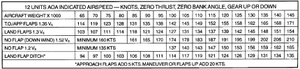

Holy Sh!t. 50 kts behind you on 7500 ft of runway. I don't even know if that's possible. I geeked out and was curious what the landing ground roll for that would be. The best I could do was a 20 kt tailwind and that gave something like 3000 ft to stop the aircraft with hard wheel braking on a bone-dry runway. Make conditions a little more sporty, like a wet runway and you start running out of runway quick.
Maybe you could do it if you planted the main mounts on the very start of the runway. I can't imagine setting down at 170 kts-ish ground speed then having to wait for the speed to bleed off to prevent pitchlocking and being able to come on the brakes and not blow a tire. This all makes me think the fish has gotten bigger over the years.

Jim- Landing speeds are usually between 140-ish and 120-ish depending on configuration and weight. Not exactly blazing, but faster than a helo.
Flugelman- we don't get to do that anymore unfortunately. Sounds like a fun road trip.
webmaster
The Grass is Greener!
What NavAir said... typical LAND FLAP speeds into the flare would be between 114-127KIAS. Touch down 6-8 knots below.
We have to wait until our speed is below 135 before coming into reverse to prevent inadvertent pitchlock of the propellers (overweight/no flap emergency landings, etc...).
