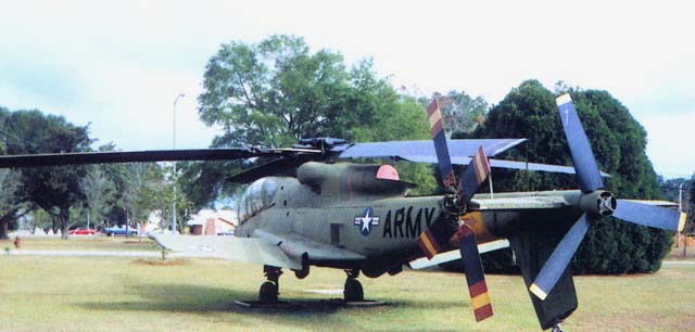

The last helicopter I know of that Lockheed built was the AH-56 Cheyenne prototype. 200+ knot compound helicopter - ahead of its time. Scared the Air Force so bad that they built the A-10.
Lockheed's deep pockets will make Sikorsky formidable.
