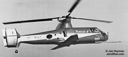

As a helo guy you need to know who Frank Piasecki is. Do a wiki search. He invented the Tandem rotor helicopter and was the main advocate for the Naval use of rotary wing aviation. He's a legend. Right there and equal to Igor. Period. End of discussion. Before developing the tandem helicopters for which he is known, Frank Piasecki built and flew the PV-2 single-rotor craft in 1943. A result of three years' research by his company, the P-V Engineering Forum, it had a three-bladed, 25-foot (7.6-meter) rotor and was 22 feet (6.7 meters) long.
His accomplishments are remarkable. Piasecki aircraft produced such famous workhorses as the HUP and the H-21
and
http://www.aerofiles.com/pia-H21.jpg
His ducted fan research on rotorcraft is extraordinary - ask any TPS grad and they will tell you it's doable. It's just getting past conventional thinking of Sikorsky and Bell/Boeing.
Piasecki aircraft became Vertol corp - the inventor of the CH-46 and CH-47 series. Vertol was later acquired by Boeing and became Boeing Helicopters.
