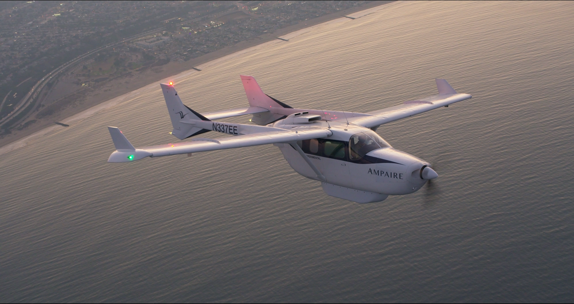

With reference to road bound EVs, here is an interesting story on EV progress in aviation…
As battery technology gets better I find myself in the camp of people who believe this is the future for non-turbine General Aviation. All this talk of compression engine technology (diesel / JET A) will finally die and be leap-frogged by battery based EV technology. Its not difficult to imagine the airframe retrofit option - with wing mounted batteries supplanting fuel tanks. MTBF specs will come of age as will appropriate Part 23 like redundacy. This is the only hope to keep GA somewhat accessible and affordable.
As battery technology gets better I find myself in the camp of people who believe this is the future for non-turbine General Aviation. All this talk of compression engine technology will finally die and be leap-frogged by battery based EV technology. Its not difficult to imagine the airframe retrofit option - with wing mounted batteries supplanting fuel tanks. MTBF specs will come of age as will appropriate Part 23 like redundacy. This is the only hope to keep GA somewhat accessible and affordable.
I imagine some kind of hybrid model will get us there, especially in helicopters. Still, I’d love a Griz-O-Copter that could travel 300 miles or so on a single charge!
