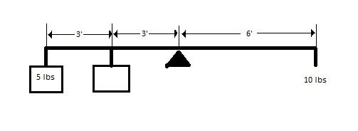

Thought I would throw this question out there. I have been studying non stop before my test date arrives and I am trying to know the ins and outs of every type of mechanical equation. Borrowed from the Mechanical Aptitude and Spatial Relations Test.
I would guess 10 pounds? Are there answers in the book to check?
Yah there are. The original question was slightly different than this one, I just moved some of the numbers around. However the same formulas apply. I am no expert by any means, nor do I claim to be.... just a simple dude studying books.... the answer and explanation the book makes absolutely no sense, but if you use some of the gouge mechanical informational than you can get the right answer. Makes me wonder who the hell is writing these books I buy on Amazon...
(Force)(Distance) = (Force)(Distance)
(6)(5)+(3)(X) = (6)(10)
