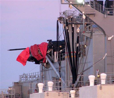

Just don't end up like this guy (160 SOAR on the USNS Artic).

I'm an outsider. Would some kind of RAST prevented this? Infamous video to follow....
