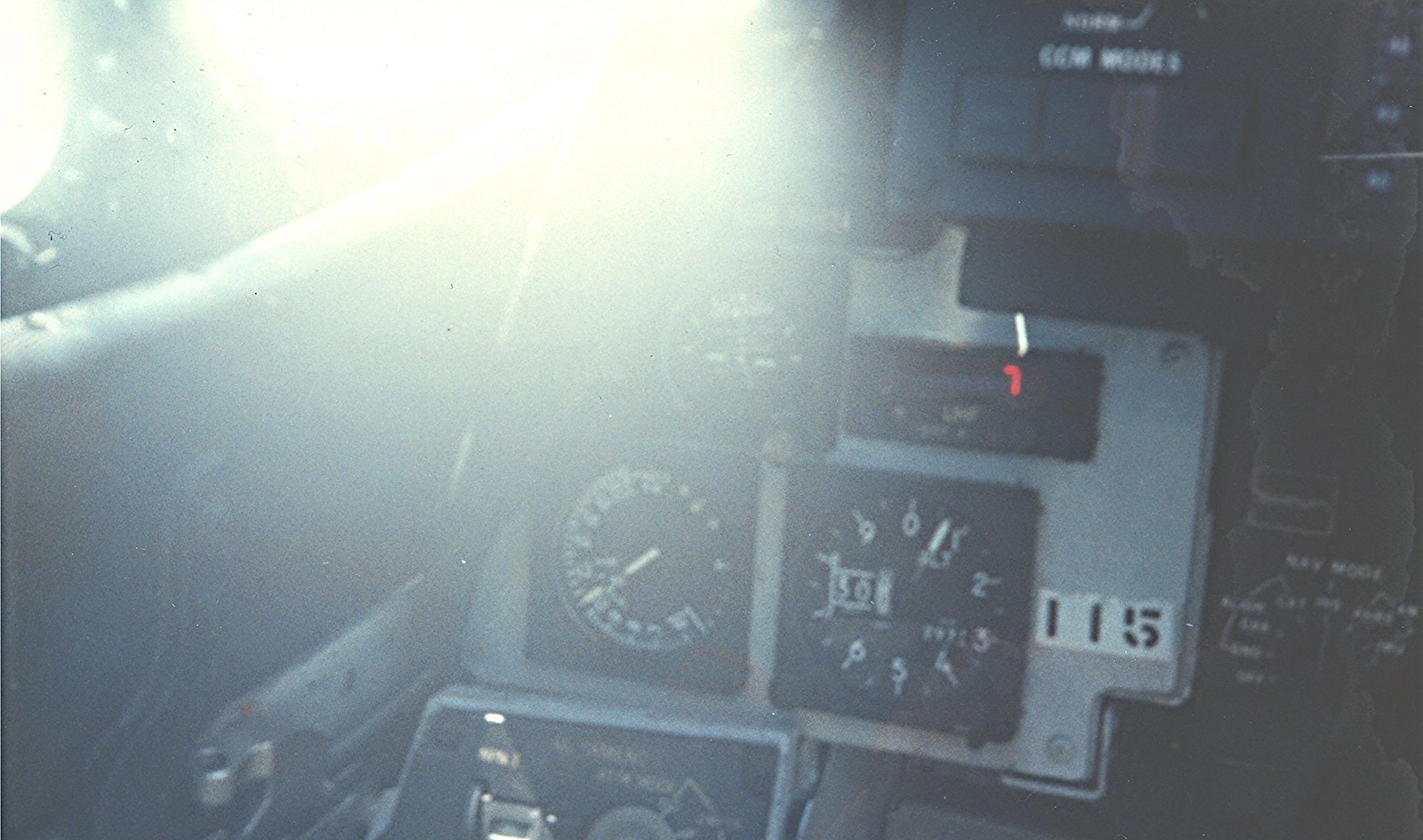

As to the Baghdad run, we climbed to 25K and unloaded right down to 5K. Around 10K, the inlets are amazingly efficient and engines get quite a boost in that realm. You can feel it like an old 4 barrel carburetor kicking in.
Ah, that makes sense. Yeah, we were at 30K (I think...it's a little hard to tell in the blurry image from my low rent Vivitar point and shoot). You can see we were in a descent as well.
