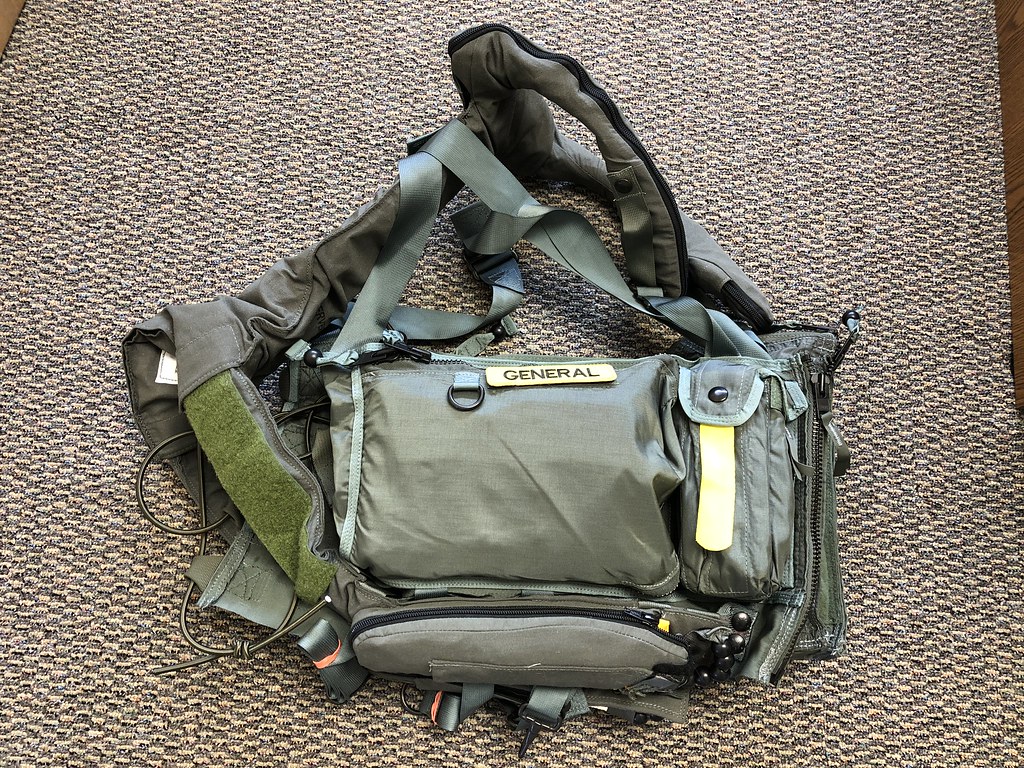

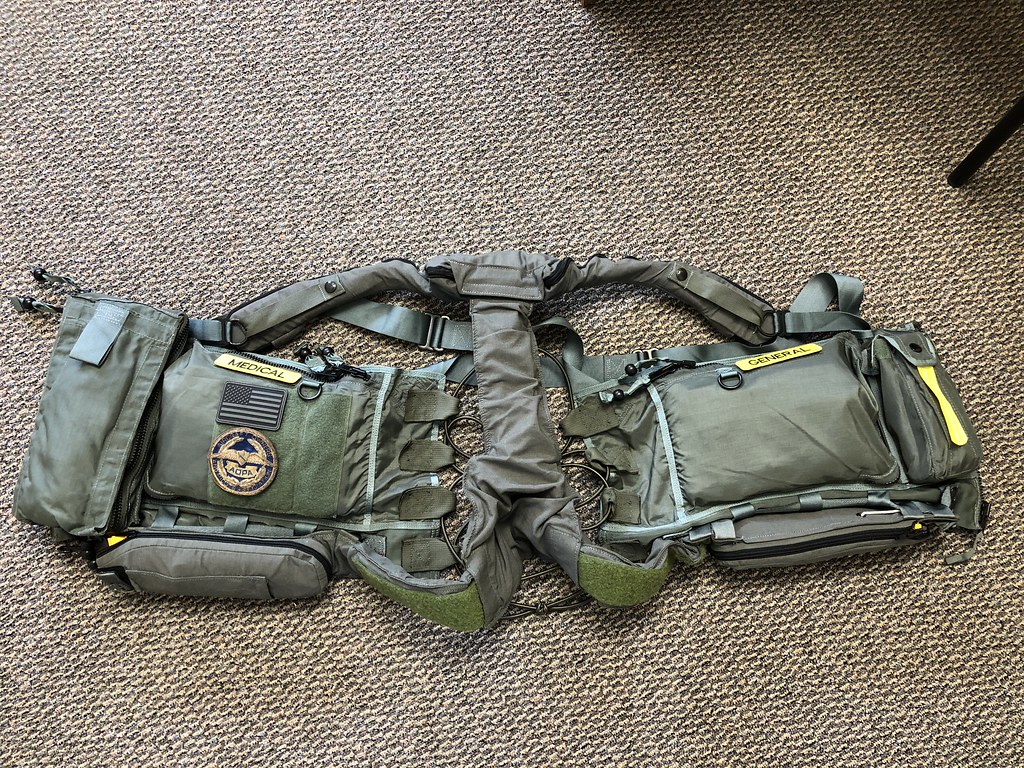

It's been a while and I can easily geek out on this stuff. Mostly it's that I'm always intrigued by clever gear. Please critique:
I just "finished" (truthfully, these things are always a work in progress lol) building this kit. I've been through several iterations of vest setups (such as a tactical sort of chest rig with molle pouches) in the intervening years (!) lol.
Thought process:
  • Basic kit that handles most contingencies that is always on your person.
This would mean something that attaches to the body. Perhaps a belt kit, maybe a vest, maybe cargo pants with pockets; any/all of which can be fitted with certain items.
I chose a vest. I'm a fan of mil stuff and I also believe those kits/setups are a result of many lessons learned. So I used that 'system' in creating this setup.
Base unit: SV-2B survival vest, new-old stock in bag (ebay)
PFD: LPU-21 (new production, $.$x10^87) which attaches to the vest and remains unobtrusive. This is the E/P model that seems to be meant more for the CMU-33 vest, though it still secures well enough to the SV-2B.
Again, I 'just' finished it up, but I have tried it on a couple of long car drives and found it to be rather comfortable. I still have to try it in the typical GA plane. If it is too large then my next system would be based on the Switlik X-Back Molle PFD vest with their pouches. It will likely mean the loss of the pistol (not a tremendous concern) and some smaller items. I would have to work out how best to keep the radio on the vest.
Contents - left to right:

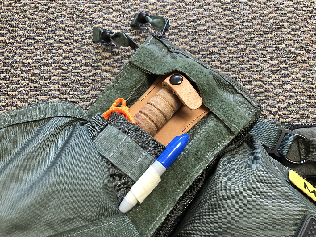

OKC ASEK(nife). A Gerber Prodigy also fits. Many people say the OKC is a marginal survival knife and I concur. It's not really meant for bushcraft though. It's meant to be an Aircraft Disassembly Tool, to get the heck out of the aircraft. Still, the Prodigy is a better bushcraft tool.
Orion Pocket Rocket w 8 flares. I'd prefer the mil style to penetrate tree canopy.

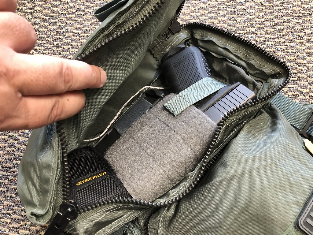

Glock 19 and two mags. Still 50/50 on a sidearm but there are gators in FL lol. A 9mm may not be much but perhaps 15 or more 9mms would lol.
Leatherman Wave with the two bit 'sheets' and the extender in a LM sheath

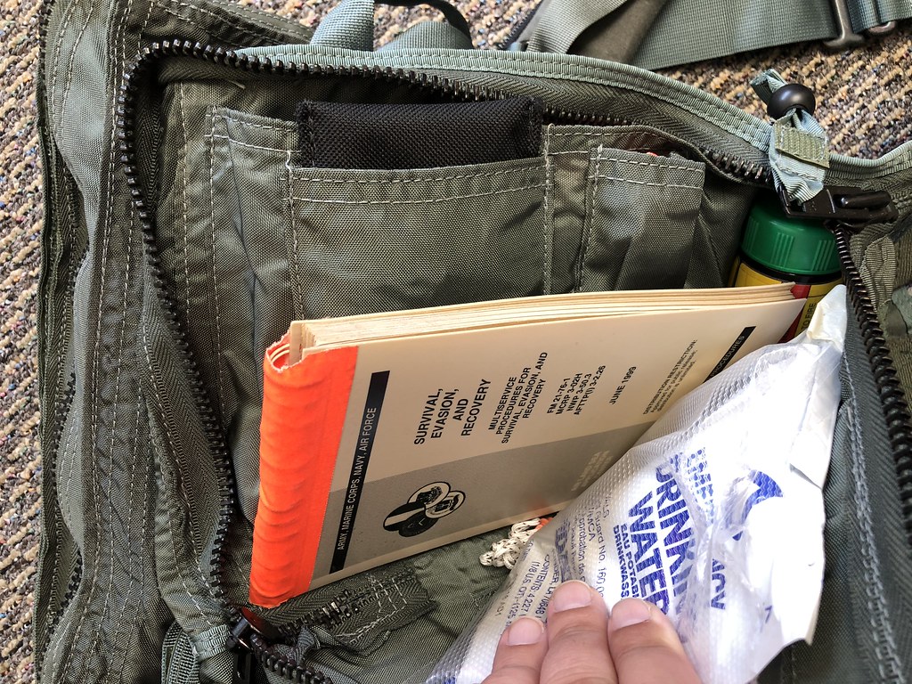

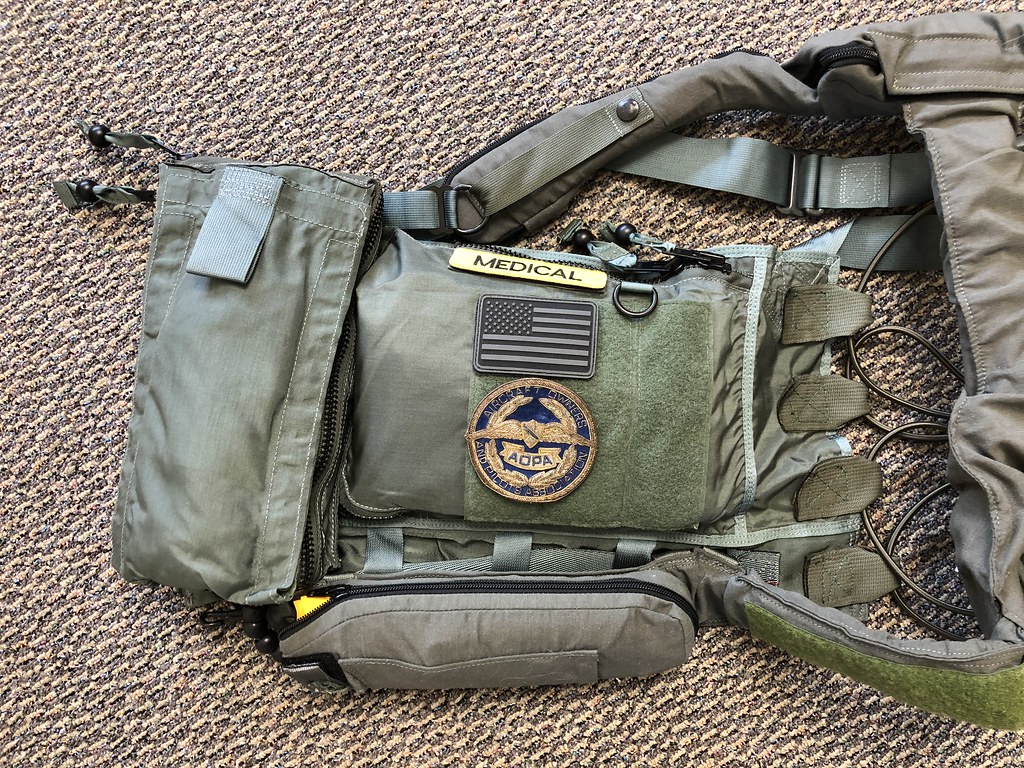

Medical Pocket:
SI Howard glass signal mirror, 2x3
Fox 40 Classic whistle
Day/Night Smoke/Flare
Multi-Service survival manual

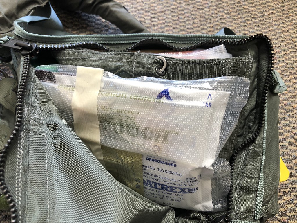

Datrex 4oz water x 2
Share-size M&Ms lol. 420 total calories
Aqua-Pouch, holds 1 quart
Micropur MP1 water purification tablets x 10

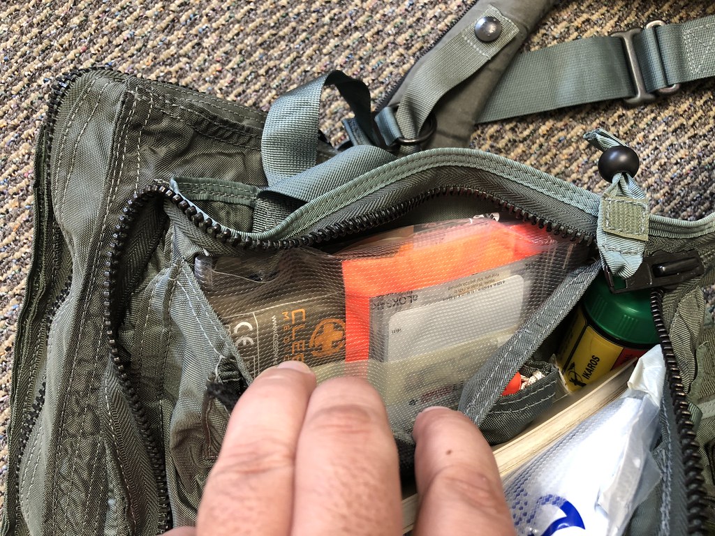

CLEER compression bandage
Triangular bandage
Dramamine 24hr
ITS Boo Boo kit (https://store.itstactical.com/products/its-boo-boo-kit)
Dermasafe razor
Vial with tweezers, safety pins and sail needles
Sunsect 0.3oz foil packs x 4

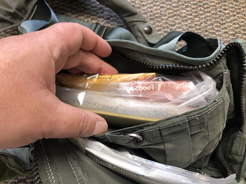

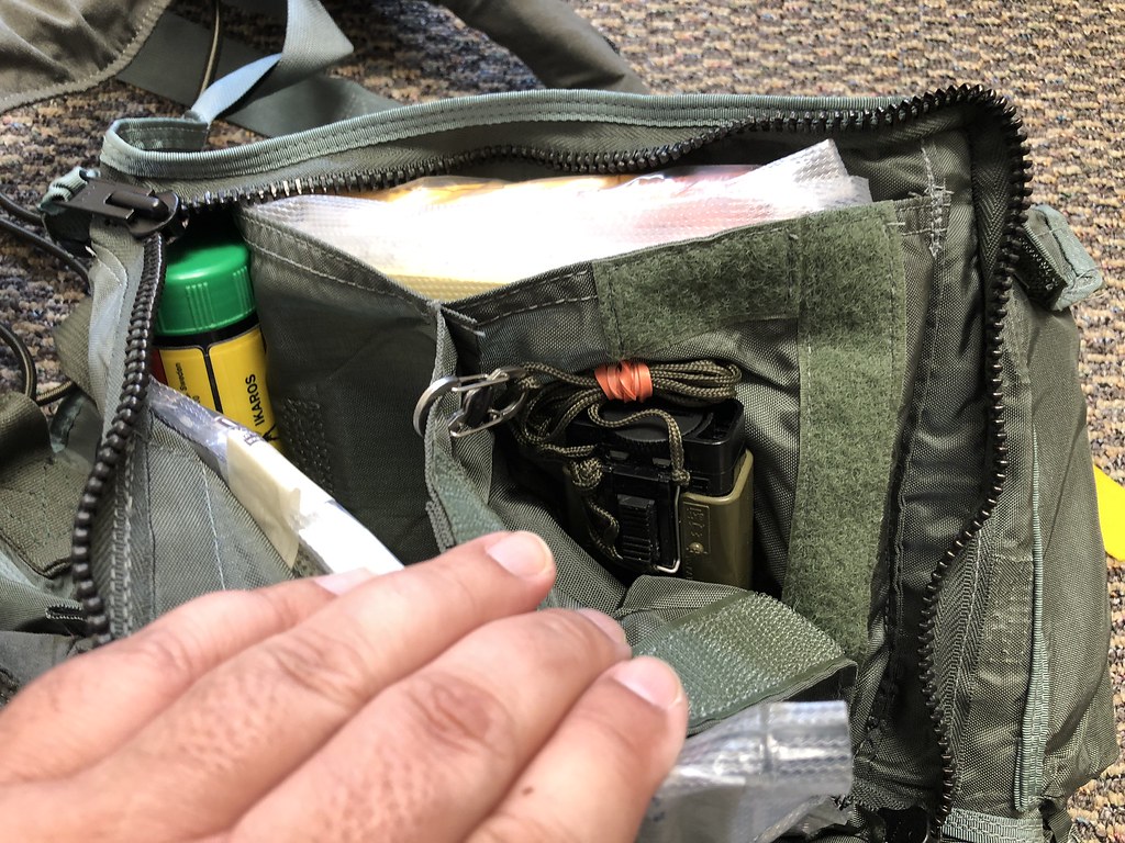

General Pocket:
ACR MS-2000M strobe, just cuz I like it :D
Share-size M&Ms. 420 total calories
Survival/Bushcraft kit, which includes:
  • shelter (2pers SOL heatsheet, 50ft 1A paracord, wire saw w rings and spare wire). I once had to make a shelter, from the sun, and the heatsheet as a sunshade, mirror side up, made a tremendous difference. Underneath was -comfortable- while above you could easily see the mirage of the heat being reflected, and you could definitely feel it if you put your hand a couple of inches above.
  • Duct tape roll
  • Compact fishing kit
  • Compressed sponge (water collection / filter)
  • Petzl e+lite headlamp, the model w the string 'headband' and two spare CR2032s. Sidenote: the unit uses two CR2032 batteries but if you turn over the top one it will still function (at a lower brightness) on the one cell. The edge of the cell, vs the flats, is what completes the circuit in the system. You could effectively have four cells available.
  • Cammenga tritium wrist compass
  • Rotary sparker with 8 tinder tabs
  • Mosquito headnet and mittens
  • Kroops collapsible skydiving 'goggles'

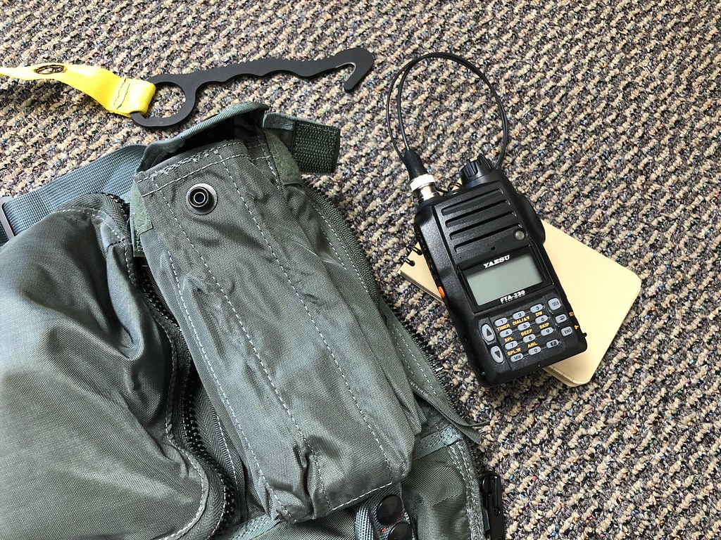

Radio Pocket:
Yaesu FTA-230

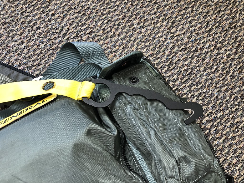

Benchmade 8 Hook
Rite-in-the-Rain small spiral notebook
I made another mod (molle format sort of thing, see final pic) to the vest so I could add the single-molle-column pouch for my ACR PLB. This takes the place of the velcro-backed open-ended zipper pouch that held the oxygen hose.

Standing by for the RIF !
I think the AF has eschewed survival vests for the fighter types - opting for floatation attached directly to seat harness. The Navy SV-2/LPU combo was unnecessarily heavy and bulky. We kept it around too long. Honestly I would opt for collar lobe flotation on a lightweight vest that carried illumination, a knife and basic signaling - something that would not get hung up when I needed to egress in a ditching scenario. Add tourniquet and clotting media in combat scenario and a weapon. And don't get me started on HEEDS....
Wow, where the hack do you fly as a GA guy and what do you fly? Sure, I carry a survival kit, but it consists of a first aid kit, beacon, a flashlight, strobe light, radio, compass and a multi-tool. I have a basic inflatable PFD (used by most boaters) if I fly far more than 3 miles from the shore (in my case up the middle of the Chesapeake, the swing around JFK by staying out over water...or maybe out to Nantucket. I wouldn’t carry a pistol at all. Land at an airfield in the wrong state and you could find yourself spending a night in jail if caught. Heck, I have flown from the west coast to the east in an open cockpit with less stuff. Up in AK a lot of bush pilots consider a coat a survival kit. In my opinion, if you go down and survive, your best bet is to walk to the nearest town.
If this is a hobby, that’s cool, but it strikes me that you are wasting a lot of room and comfort in most planes.

True it is half-hobby. I’m the type where my hobbies have to also be functional :D.
This is why I was thinking possibly the Switlik X-Back for size. It is a collar floatation style with molle in the rib areas.
