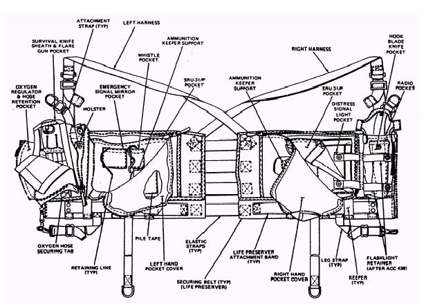

Thanks for the info. Hey I was wondering, does the Navy use a survival vest like the Air Force does for all the gear that a pilot/NFO/Enlisted Aircrewman has to carry or do y'all still use the old ALICE-like system.

The Navy now uses the AIRSAFE Vests (CMU-33's). It is basically made out of a mesh type nylon and 1" nylon webbing loops. It is basically integrated with harness and a D-ring.
I miss the old SV-2 vests and the old integrated torso harness - much easier to maintain. The SV-2 vests are still around for spare gear.

What do the CMU-33's look like? Are they similar to the Air Force issue survival vests?
Yes, same gear, just how the different services put the pockets on varies. Sometimes you'll see the AF or Army wear what looks like a fishing vest. When they don't wear those, they both are now wearing a version of the CMU-33.
If you go to the Navy or Marine website, and look at any pic of aircrew, you'll see a CMU-33, w/ or w/out the flotation installed. It's a heavier vest, despite what "they" say, and it's a pain to deal with at first, but after flying w/ it for 3 years, I actually missed it going back to an SV-2. However, if I was in the water and having to survive w/ it, I'd want the SV-2 all the way up until they hoisted me. Then I'd go back to the Airsafe. The integrated harness of the Airsafe is much more comfortable to be lifted, but the flotation of the SV-2 is much easier to deal w/ in the water.
