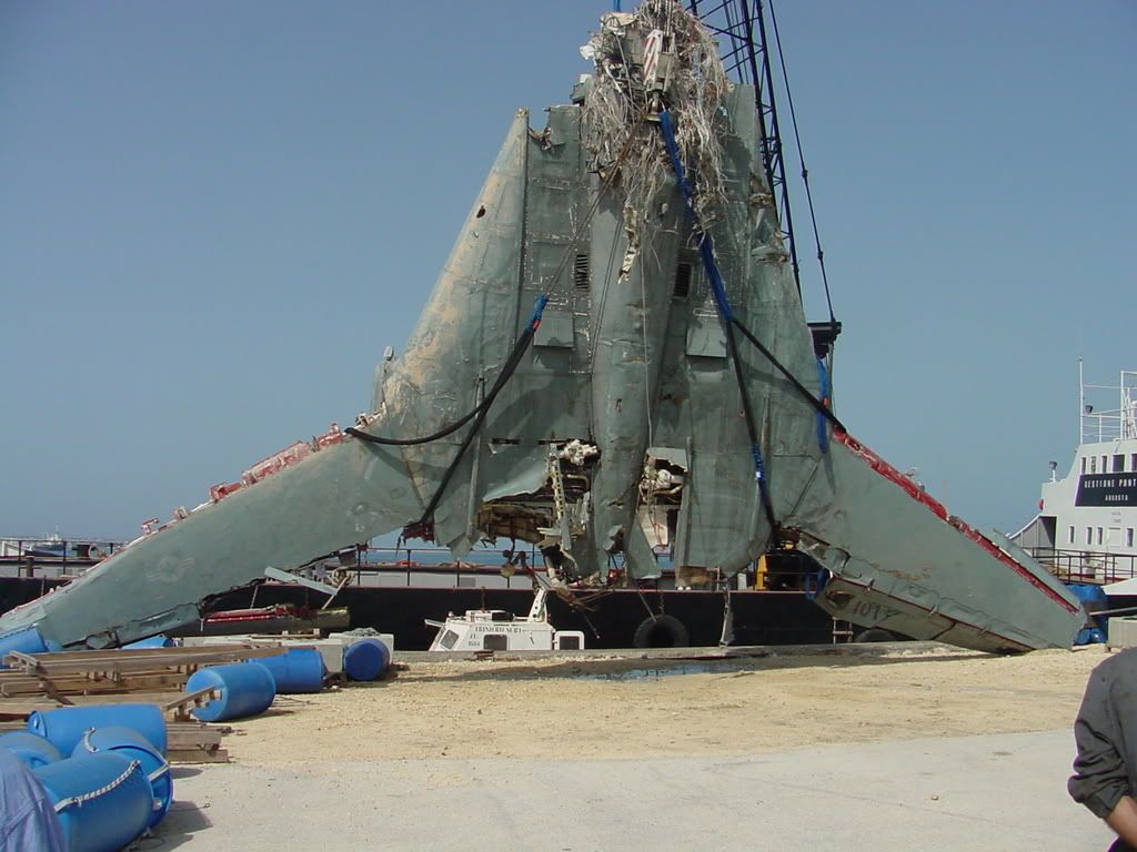

I have always wondered what happens to the a/c that go down like the hornet recently. Do they take them out of the sea or leave them there? Forgive me if this is a meaningless question.
HeyJoe
Fly Navy! ...or USMC
To salvage or not to salvage?
Several things are considered before they determine if a salvage effort is warranted. First, it depends on how deep the water is and whether it can be salvaged making it a moot point even if salvage is desired. There are two top reasons aircraft are salvaged:
1) Cause of loss is questionable and salvage would give investigators important clues
2) Aircraft contains classified equipment that cannot be left for "others" to exploit (most famous was loss of Tomcat and a Phoenix missile in international waters early in operational carrer and fears the Soviet UNion would mount a salvage attempt if US did not*)
Another reason warranting salvage is if wreakage is a hazard to navigation (in shallow water)
Salvage of F-14 Tomcat
US Naval Safety Center
* ...on 14 September 1976, VF-32 lost a Tomcat some 60 nautical miles north of Scotland when an F-14 experienced “runaway engines” and began to skid across the flight deck. Lieutenant John L. “Lew” Kosich, the pilot (CVW-1 staff), mindful of the pack of aircraft spotted forward, alertly steered the Tomcat toward the deck edge. Just prior to the F-14 going over the side into 315 fathoms of water, Lieutenant (j.g.) Louis E. “Les” Seymour, the NFO, initiated command ejection, and both men landed on the flight deck with minor injuries. Intensive deep-water salvage operations recovered most of the F-14A and the missile it carried. (excerpted from official history of USS John F. Kennedy)
