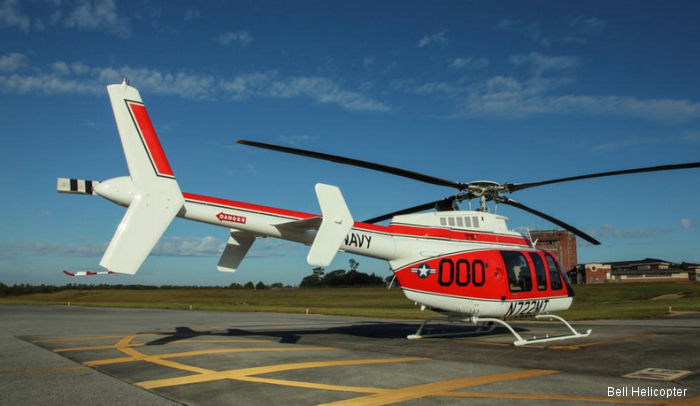

The one thing that I don't see any discussion about for the TH-57 replacement is the IFR piece. Its a huge part of the curriculum and has been put forward as a fundamental requirement by the Navy. The Navy places high value on the Instrument training and will not differ a large percentage to simulation. Remember anyone who gets winged out of S. Whiting could easily be flying at night off a ship as an H2P within 6 months in the middle of the Indian Ocean or Med. Exceptional IFR training is the hallmark of a naval rotary wing pilot. The only aircraft in the running that seems to be taking the requirement seriously if the TH-119. The Bell 407 has a lot of system level redundancies to figure out or it woun't be anymore successful than the TH-57D program with IFR certification. After reading about the 407 and the TH-119, the same Garmin G1000H cockpit are in both VFR versions of the aircraft but cannot be made compliant to meet the FAA standards which is why the TH-119 made the change to the already IFR certified Genesys (used to be Cobham) cockpit. View form S. whiting is Bell may be the incumbent but they haven't had anything to do with S. Whiting in at least 15 years and are well behind the TH-119 in giving the Navy what its asking for.

PS-twin engine fans saying that the new helicopter should just be a twin, ask yourselves why did primary go with a single engine (T-6B) again, and how many EP's in combat multi-engine helicopters besides the AEO EP, have "give yourself a full-auto" as the final step ? Anything involving loss of a T/R for starters...... So the skills and confidence you learn at S. Whiting (and Rucker until the prohibition thanks to the UH-72) by doing full touchdown autos carries you through your entire career and in MY OPINION does a disservice to the pilots and passengers if they don't get that experience.
The skill you learn/use over 3 weeks of flying - in an aircraft that is completely unlike fleet aircraft - translates into career-long confidence?!
In a V-22, no. In any other MR+TR helicopter, I think so. Whether it's a teetering, high-inertia rotor or a fully articulated low-ish-inertia rotor, it's still a rotor. The H-60 is far less forgiving in an auto than the H-57, but I think the "I can do this" feeling sticks with people for a while.
