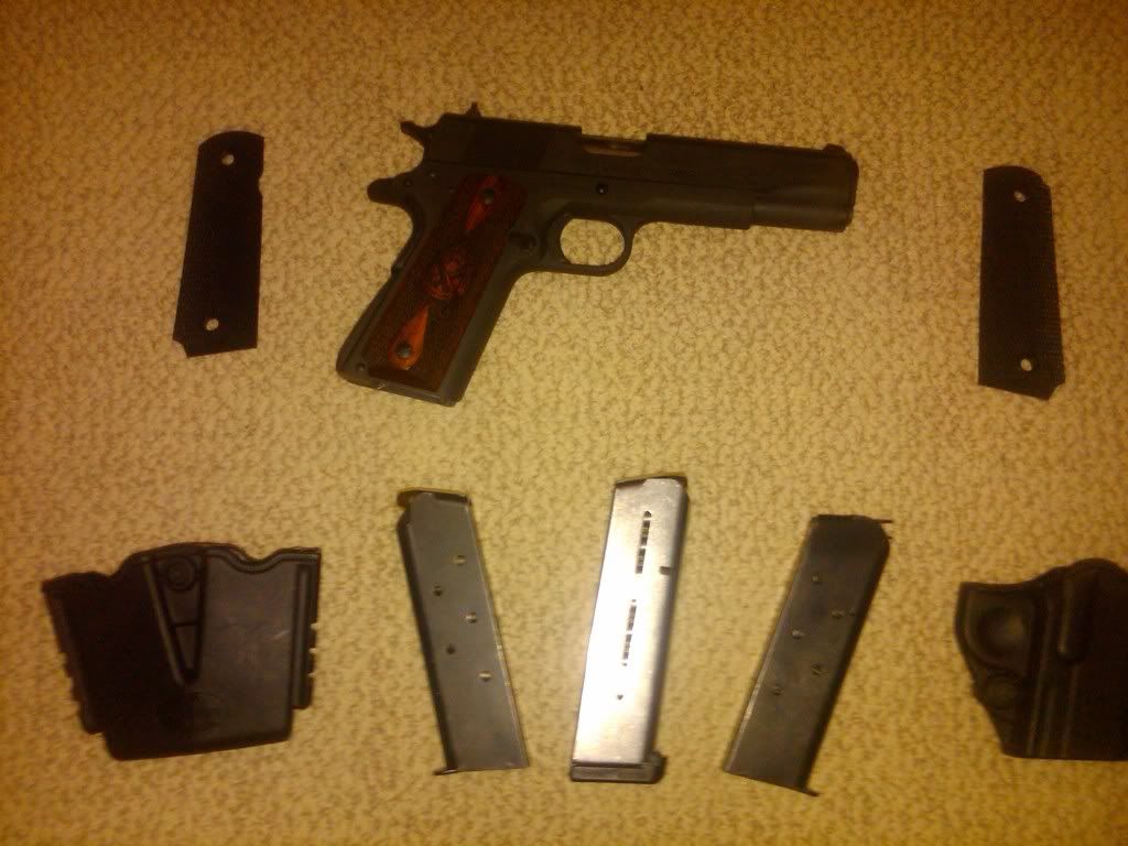

After Gaijin helped with some info via PM, he's reminded me about my latest purchase and lack of Proof of Life. Here's a pic, albeit of crappy quality. It was the end of the day and my cell phone doesn't have a flash. 200 rounds so far and no issues.

Wanted to buy a 1911 this year, being 2011. Had decided on SA Mil-Spec a while back for my first 1911... Stainless turns me on but they had a Mint Pre-owned Parkerized for $550... So I got it *) . 50 rds FMJ and 8 Golden Sabers this morning w/ no problems whatsoever, shoots like a dream (esp. for a low/mid grade stock 1911 ;) ).
