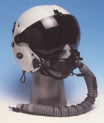

HGU-84/P
The superior ALPHA

Well first off - it's light, and strong. The shape sits higher but overall has a lower profile.
Allows your bean to stay cooler..
More eugged visor system
Better balanced for use with ANVIS
The AF is adopting it as their standard aircrew helmet - jets for starters - as the HGU-86/P - they should start issuing them in 2007. AF believed it was a better design than the HGU-55 that they had been using for the last 20 years (and the Navy just adopted).
Qoute from manufacturer:
With a nominal weight of only two lbs (980g) the helmet's epoxy resin aramid carbon fibre shell offers high levels of protection in a range of applications including multi-function helicopter operations, use by police and emergency services, forestry and crop spraying organisations.
The wearer comfort of the Alpha 900 is enhanced by its EPS inner liner and a cushioned cloth interior--designed to inhibit the formation of moisture, improving hygiene and reducing thermal heat load.
Adjustable ear-cups provide excellent passive noise attenuation for protection against the potentially damaging low frequency noise levels experienced by helicopter aircrews.
In common with the manufacturer's proven modular based Alpha configuration, the basic helmet can be adapted to meet different operational requirements using a wide of equipment and options.
These include single or double visors with clear or tinted screens, a choice of semi-rigid or NVG compatible visor covers, ANR (Active Noise Reduction) and a choice of boom microphones with compatibility for most on-board communications.

Thanks, Chuck. It looks like a pretty solid piece of gear, so it's no wonder we don't get to play with it. The visor system looks a lot better than that elastic crap we've got on ours. Just par for the course, I guess.
I'm not sure if I like the idea of active noise reduction, though. The armor and LAV guys have Bose ANR in their headsets, and they have trouble with it on occasion.

Yup, those 13.4s are nice gear. The issue w/ the ANR stuff is that it gets fried at the boat, even on non-SPY ships. One issue I see w/ those Alphas is the visor hinge point. Obviously I don't have it in my hands to look at, but in the pic, it looks like it could crack or snap when it's not being used (like something banging into it). It may be better designed than that in real life. A better balanced helmet for NVGs would be a welcome thing for my long head. I'm right in between sizes w/ the Gentexeses.
