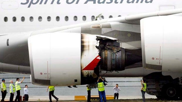

On 4 November Qantas flight QF32, an Airbus A380 outbound from Singapore, ran into serious problems when a turbine on its Rolls-Royce Trent 900 engine suffered an uncontained failure. We caught up with one of the five pilots onboard, who describes how the crew professionally dealt with the incident, the sequence of events, and how the most dangerous period was after they had landed.

The Engine 2 was shut down. Part of the damage caused Engines 1 & 4 to go into a ‘degraded’ mode. The engines were still operating and Engine 3 was the only engine that was operating normally. Basically, dealing with all those things took some time, then the next series of messages were hydraulic problems. We had indications that the green hydraulic system was losing all its fluid. The Airbus A380 carries two and, unlike most conventional aeroplanes, most flying surfaces aren’t powered by hydraulics, they have their own electric-hydraulic actuators. There is a green and yellow system and they spilt their duties between things like brakes, undercarriage retraction/extension. With the green system out we had to deploy the nose gear and body gear using the gravity extension system. With the loss of the green system we dealt with that and curiously we had the hydraulic pumps of Engine 4 indicating failed as well. Engine 3, the trusty engine, was the only engine that was producing hydraulics for the aircraft for the yellow system
ASChan: When this was happening, what was going through your head in terms of ‘this seems more serious than an engine shutdown’?
DE: It was getting very confusing with the avalanche of messages we were getting. So the only course of action we have is the discipline of following the ECAM and dealing with each one as we came through with them. The engine shutdown was completed, the hydraulic systems were dealt with and then the next systems we were looking at were the loss of various flight controls. This was due to the degradation and the loss of some electrical buses, bus 1 and 2 had failed. Basically, just going through the ECAM actions, acknowledging them and working through the systems display to see what was working and was not.
The next thing we were dealing with was the fuel. We had some obvious leaks, some severe, out of the Engine 2 feedtank. We dispatched the second officer back to the cabin to have a look and there was a fairly significant fuel trail behind the aircraft – or fluid trail because at that stage we couldn’t determine whether it was hydraulic fluid or fuel. We were getting messages about imbalance, losing fuel out of one side and not the other. And those messages were some of the ECAM messages that we didn’t follow. We were very concerned the damage to the galleries, the forward and aft transfer galleries, whether they were intact, whether we should be transferring fuel. We elected not to.
We ended up with quite a significant imbalance between the two – nearly ten tonnes of fuel. That took time to absorb and discuss whether we should or shouldn’t. Subsequent to the hydraulic system we lost some braking, the wing brakes went into what they call the emergency system – ‘accumulator only’- this gives about three or four applications before the accumulator runs out of brake energy. Also the anti-skid on the wing gear. Now with the antiskid being unserviceable on the wing gear its very important to have the aeroplane nose gear down that limits the braking on the wing gear to 1,000psi. If you have lift and not all the weight on the wing gear you run the risk of locking the brakes up and bursting tyres.
Then we come to the electrical system. Bus 1 and 2 we’d lost. We looked to start the APU but it wouldn’t take up any of the load. It just managed to burn fuel – that was all. Engine 1 drive had disconnected. Again there was a procedure to follow. We had pneumatic leaks. We had major air leaks, pneumatic leaks, in the left wing, Engine 2 bleed leak and outer wing leaks. The leak isolation system had taken over to seal up the holes for us – which was a good thing.
We lost one of the landing gear computers and once we’d extended the undercarriage using the alternate system we had no indication it was down until we’d gone to the system page to make confirmation of that. Happily it indicated that the remaining system told us the wing gear had extended correctly. And then the autothrust – with two engines in degraded mode (including Engine 3) we’d lost the autothrust and all the thrust control was done manually. Various vent, air conditioning and cooling systems had also failed. With Engine 1 and 4 being in degraded mode it was discussed whether or not to really use those actively and the decision was made to leave them in a particular power setting and control the aircraft’s speed with Engine 3 only – the one engine that was in a normal mode.
And once we had established all that then we had to work out whether we could actually stop on the runway that was available to us. We didn’t have the ability to dump fuel, the fuel dumping system had failed and we were about 50 tonnes over our maximum landing weight. In the Airbus and the A380 we don’t carry performance and landing charts, we have a performance application. Putting in the ten items affecting landing performance on the initial pass, the computation failed. It gave a message saying it was unable to calculate that many failures. So we then looked at them in more detail and rejected ones that we considered minor and things that were affecting landing performance on wet runways. It was a beautiful day in Singapore thankfully and not wet so it obviously wasn’t going to affect our landing performance. After we’d eliminated about three or four items the computer happily made a calculation and it gave us a touchdown speed of about 165kt and showed us about 130m of surplus runway (it’s a 4,000m runway) so basically said we could stop on the runway. We had also lost the use of our leading-edge slats which consequently with the overweight condition made our approach speed quite fast – 35kt more than normal.
The other thing we were concerned with was because we had lost the ability to transfer fuel we were concerned whether the aircraft’s centre of gravity (CoG) was going outside limits. So we ran some weight and balance applications to determine where our CoG would be and also whether or not we could keep lateral balance. Thankfully it remained within the flight envelope.
Then we elected to commence the approach. With the loss of various flight controls we decided to do control checks as each flap setting was taken. Richard, who was flying at this stage, elected to take first stage of flap and run through some manoeuvres to make sure the aircraft was controllable at each stage down to configuration 3 (or flap 3). The aeroplane seemed to handle quite well, very sluggish because of the loss of flight controls. Then we elected to extend the undercarriage on the gravity system and then do another series of flight control checks, to make sure it was flyable (which it was) and advise the air traffic control we were ready to make an approach. So we commenced our approach about 20 miles out, at about 4,000ft, giving us a nice, long, stable approach. Thankfully the weather was fine, wind was quite calm and we made the approach successfully.
