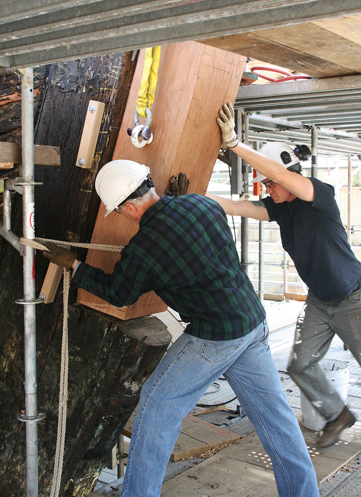

Every 8 weeks...reminds me of this story. It wasn't just about repairing ships...
Odd since much of the Constitution was constructed with Southern Live Oaks (because it lasts much longer than white oak) that came from south Georgia, not too far from where the King's Bay base is. And the recent repairs used mostly Live Oak.
