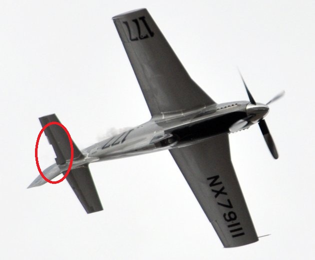

Thoughts and prayers to those involved. Here's some pictures of what was presumably the trim tab during the incident-
It certainly looks like some sort of mechanical failure from this angle-
I'm not an expert, so I'm really asking: Wouldn't that be a control tab (not a trim tab)?
Does anyone know if control tabs are the primary (only?) method of elevator control in a P-51?
It's about 3/4 of the port trim tab. The elevator is the primary control of pitch. The elevator trim is used to "fine tune" pitch.
Smarter people than me have stated that when the trim tab broke, it only broke in half. You can see the remaing half of the tab towards the outboard edge of the elevator. When the tab broke, it detatched from the servo and moved to the down position, causing the elevator to pitch up. At that speed, the tab failure was enough to induce a 10G climb, and sadly the rest is history.
Not an expert, but it makes sense.
