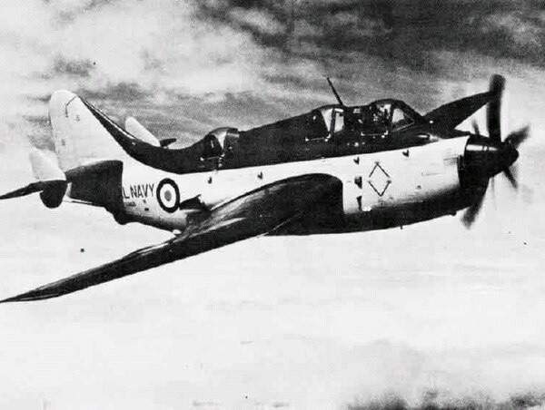

Or you could pull a Fairey Gannet, involve two engines in said gearbox, and really give the ADs fits.
I can't think of anyone else but the Brits ever putting a recip one into production.It also requires a complex gearbox and the headaches that come with it.
