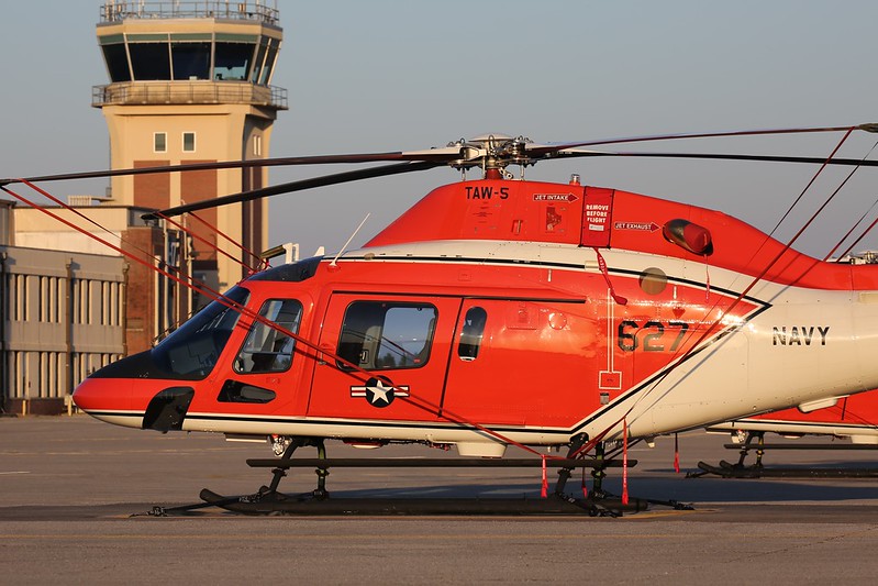

TH-73

Single Pilot IFR program?
We will be, as we grow into this aircraft. The only issue I see, is that the aircraft is a two axis autopilot with yaw dampening. So doing approaches with a step down fix could be an issue if you’re not on top of your game
That's what the -135 P2+s have. It's a non-issue. You just manage everything with collective and IAS Hold or collective and Altitude Acquire, keeping your eyes on the ball regularly. I can't remember if the -119 has a FLI or not, but you'll figure out a rough power datum to work from during the approach, be it either a FLI number or a Tq setting. For example in the -135, I know FLI 5.75 gives me about 90 knots level, and FLI 5 gives me about 90 knots in a descent (during 3K' DA or less...-ish)

I do believe it has a FLI. I’ll find out in a few weeks. Flying IFR is much easier than VFR. But SPIFR can be challenging at times. Situational awareness is key. A four axis autopilot would have been much better considering it will take you all the way down to LPV minimums by just pushing a button. Pretty much my company copied the Navy’s TH-73. And I think the Navy’s goal for the IFR platform is to have a dual pilot cockpit. Using CRM, challenge and response. Our CEO was a former Navy Captain Sea Hawk driver. So I think he was fond of what the Navy is doing.
