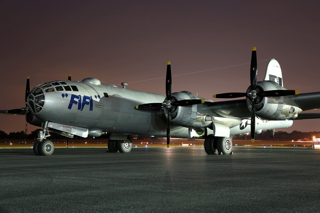

Thanks! Just 45 seconds of ambient light tends to do the trick on the ramp in Smyrna, TN (KMQY) every time..
KODAK: Just so I'm clear…was the B-29 also shot with ambient light, or some artificial? Doesn't really matter…still one of the nicest twilight shots I've ever seem...

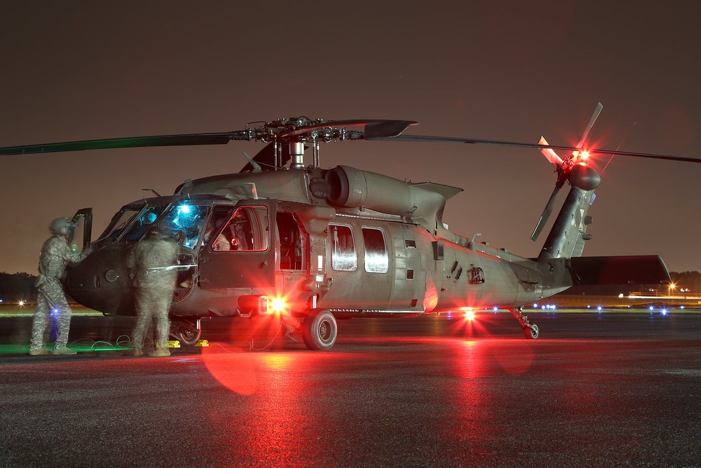

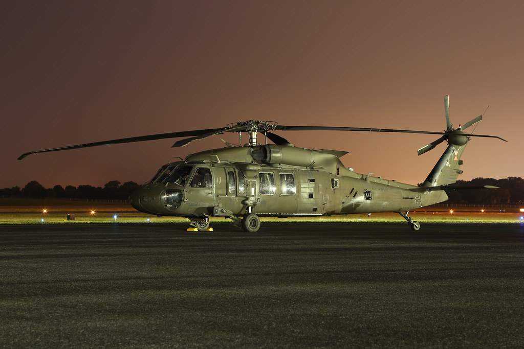

Yes, everything I shoot at night is just with the natural light that exists when I 'see' the scene - the B-29 and UH-60 shots were all taken at about the same location on the ramp. Both FBOs in Smyrna are located just to the right of the frame so they provide a lot of light..
Some folks use vehicles or even light trees to set the scene but sadly I'm not that well connected yet.

Honestly, I prefer the "natural" scenes. That being said, are you doing HDR? How do you get such clear low-light shots?

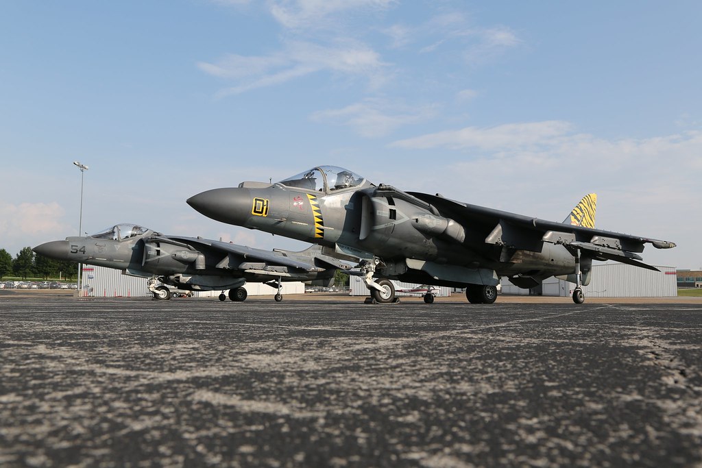

Most folks take photos from about shoulder level - it's just the natural perspective our eyes see from every day. When able I try to get really high up or really low down, just something different..

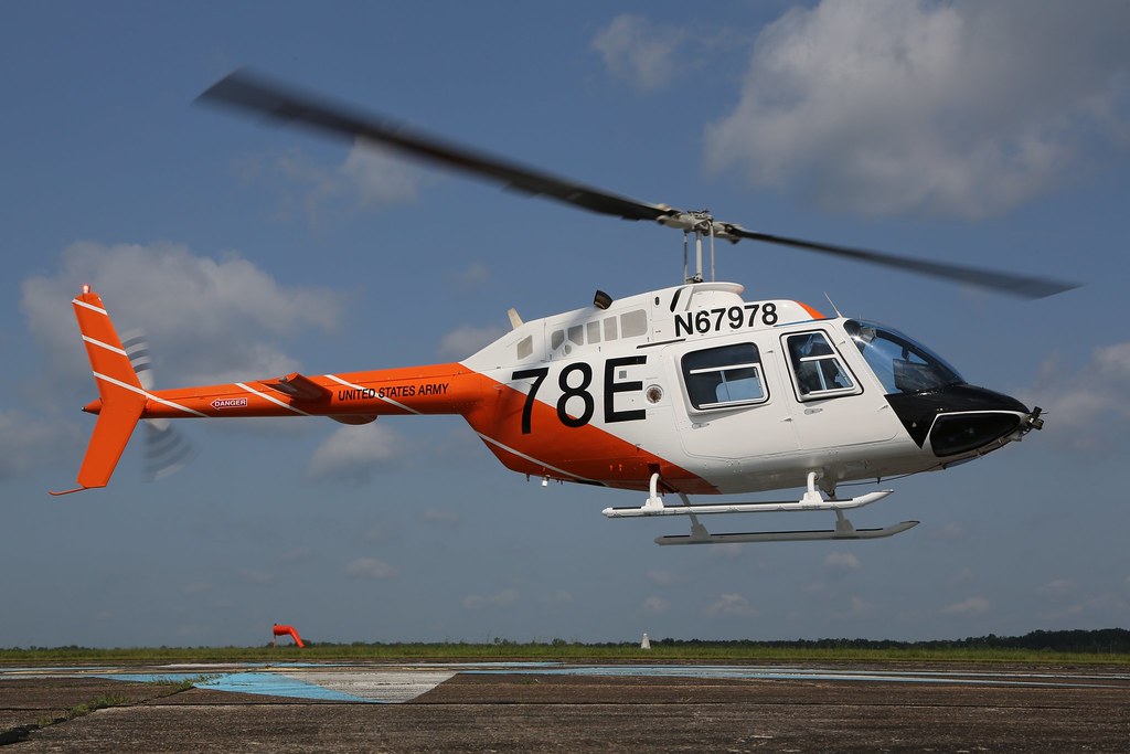

Use High ISO's for shutter speeds that are compatible with motion:
Low ISO, slow shutter, and a tripod to amplify ambient light:
Or a combination of both, depending on the situation

On pages 19-21 Mike details the basic settings to use and I usually start at F8.0 (sharpest setting for my 24-105mm lens), ISO 200 (optimal ISO for my Canon 5D MkIII), and set the camera to 'Bulb' mode while using my remote shutter. I then vary the exposure length for as long or as little as the scene requires, anywhere from 10 sec to several minutes based on the individual lighting conditions.
