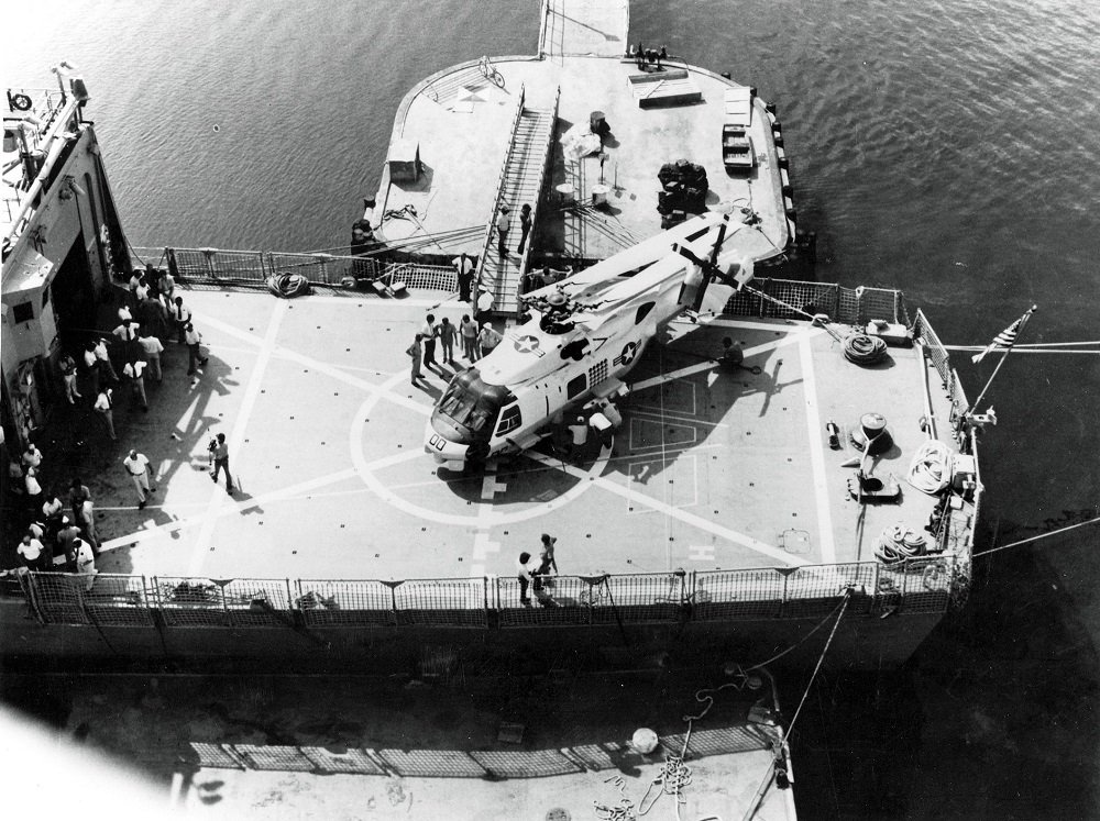

Went looking to see if there were any pics of VERTREPs to the forward station. Didn't find any but did find this nugget: mockup -60B on OHP's flight deck to test deck handling. I imagine this might have been when it became apparent the aft capstan/cleats would be way too close to the tail rotor for anyone's comfort, thus the "Long Hull" mod.
Here's a link to one of them.
Looking at your picture, you can see there's not RAST tracks or tail guide wire ports, either. When I look at what they're doing and where they have the bird, it looks like they may be trying to figure out the limit for twisting of the tail. It wasn't uncommon for the tail to hang out over the nets if you ended up in a weird position in the trap.
The short hull FFG-7s originally didn't have RAST, though I think some of them were retrofitted with it later. The one I first cruised on didn't, and didn't have an LSO station either. When I later deployed on SBR, it was interesting noticing all the differences that came with the Long Hull design.
Yeah, I'm aware. My point was that they weren't there and where the aircraft is spotted is about where it would be with a healthy twist to starboard, so they may be working on that very mod in the picture.
