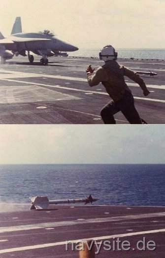

Blue-into-the Blue aboard USS Midway
Single Seat
Average member
That LOOKS like a CATM. The lau 7's on the Hornet are notorious for shedding stuff if not inspected between every flight (or properly preflighted for that matter).
