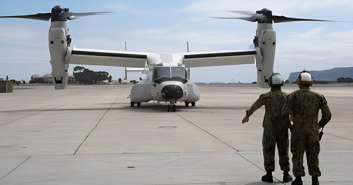

The Navy livery is awesome. I am super curious how the crew will employ the various sensors operationally...can the FLIR be used to conduct / fly an approach in low visibility/IMC ?

Probably not. Generally, IR is attenuated or blocked by the same gases/clouds that affect visible light. There is an "IR window" from 8 to 14 microns, but that is for haze, not full-on fog or low clouds. The 60B/H had a long-wave FLIR, but 60R/S have mid-wave. Is the CMV actually fielding with a FLIR?
If one wanted a self-contained approach for IMC recoveries, a radar is a better option.
What are the two small clear "bulges" underside on the nose ? Sensors? Visible lights? Strobes? IR lights? And I assume the MX-15 looking thing is a FLIR/EO sensor for viewing on an MFD. - but what is the sensor on the port side of the nose?
Not a good idea. A while back an HH60 mixed section with a Pave Low in a sand storm. Used FLIR to follow the Pave at a distance but the problem happened in the terminal environment- Pave used TFR to couple up and land. HH couldn’t see the field via FLIR but caught a glimpse of some taxiway lightning, wrapped it up and ended up tagging the stab. Wx was so bad it took 2-3 hours to find them on the field.
It's been a couple of months, but I don't think the ones at VRM-50 had them.
I'm not sure what the source of the quote or the picture is, but it seems like a render, or at least a photoshoped PR pic.
Why wouldn’t it have a FLIR?
That’s factory-standard equipment for V-22s. You never know when it’ll come in handy.
It is a good looking aircraft…with a little photoshop work.
