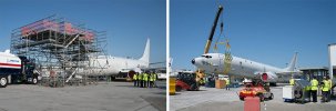

Interesting pics posted on NAVAIR's Facebook page:
NAVAIR text - "The P-8A Poseidon Integrated Test Team (ITT) conducts air-to-air refueling (AAR) ground testing with the aircraft at a level pitch (left) and flight pitch (right) to simulate the various stages of AAR. The team successfully completed the seven-day event May 11 at a Boeing facility in Seattle, Washington.
The series of tests will mitigate risks associated with the in-flight AAR demonstration, which is slated for 2016. The P-8A will deploy with the AAR capability within the next two years, and will use the flying boom, or Air Force style, method of refueling. (Photos courtesy of Boeing)"
