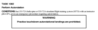

This whole discussion/debate about full autos is purely opinion based about the effectiveness of continuing the training for the Navy instead of leaving it completely to simulation like they are doing at Rucker because of the limitations of the UH-72..... I just simply think its worthwhile.
The point on autos is moot, since NAVAIR already weighed in and specified "repeated, frequent, daily autos to touchdown with no inspection required" in the RFP :) So some O-8 already made the call and HX-21 backed it up - so thats the go forward modality

For autos in the 60s, if you are doing one, you are going to have a class A. The goal (imho) is to minimize injuries. For this, I think the 5/5 recovery works in the HT school house.
