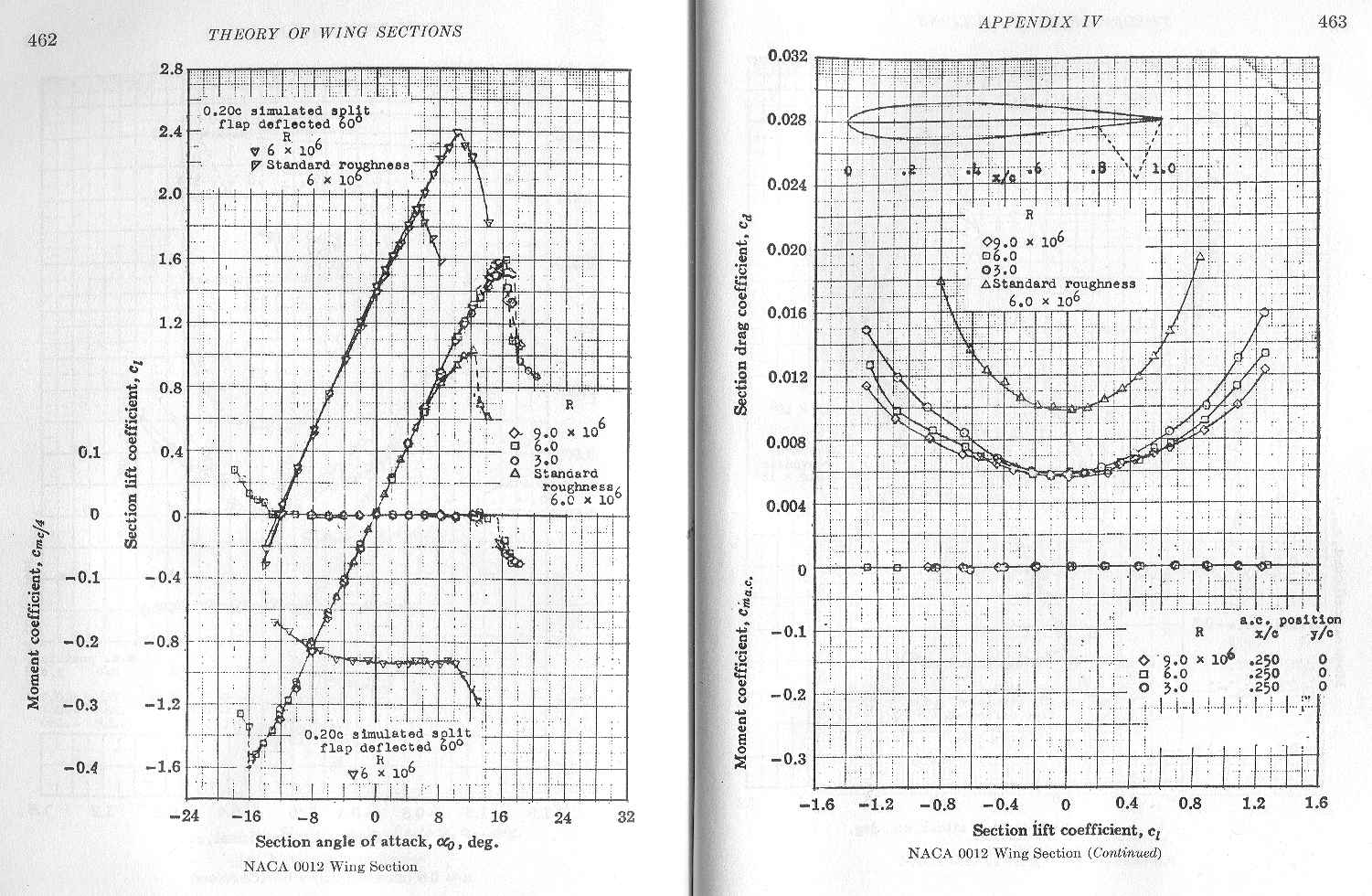

Try this...
You can also fly on the back side of the power curve....just takes lots more power than you got.
