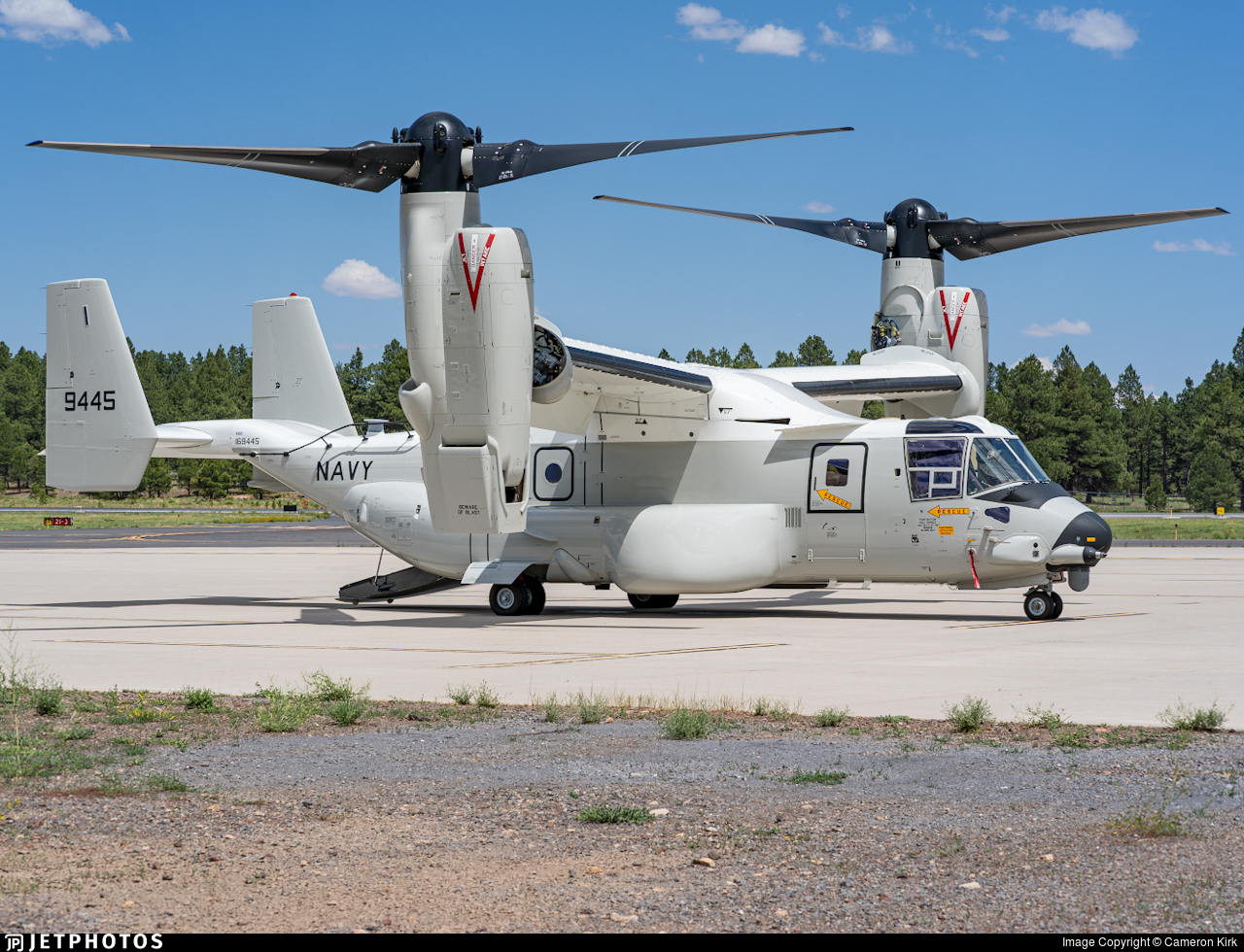

I thought all the CMV-22Bs were painted white on top?
iu
iu
I could not find a single image of a CMV-22B that does not have the glossy "white-top" livery. And it looks amazing. One of the best looking paint scheme/livery of a US Navy aircraft ever. I think maybe the lighting skewed the pic @Roger_Waveoff shared. Congrats on your return to flight!
