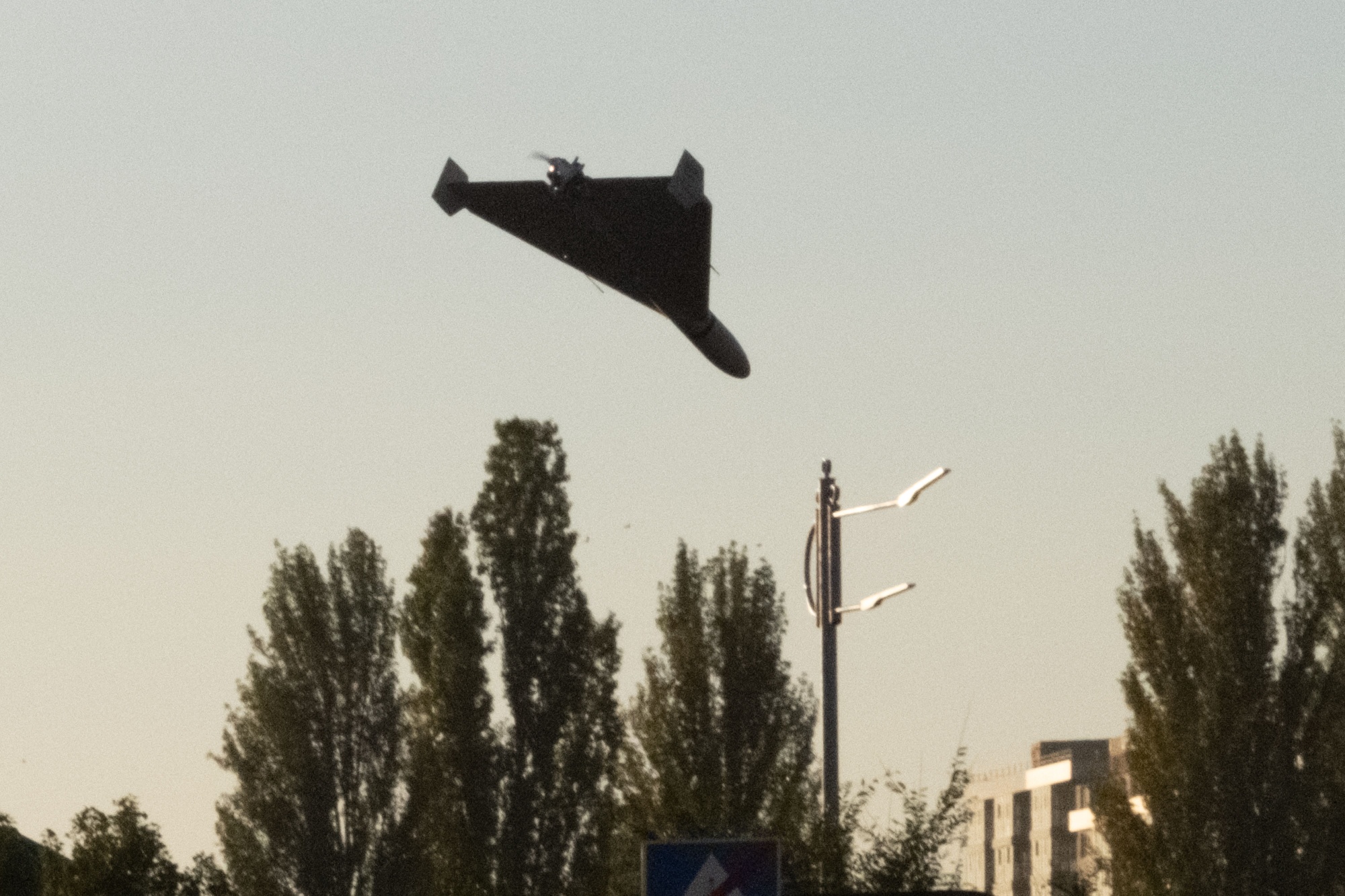

Could be the other way. In a contested environment, drones will go where its too dangerous to put humans. Expendable and potentially kamikaze.
The lines will blur between what is a drone and what is a smart weapon that has been made intelligent enough to be considered a drone on a one-way trip.
Those already exist, and are being used in combat right now.
But they are really nothing more than cheaper cruise missiles at that point, so are they really UAV's at that point...?
