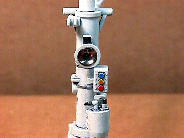

What about the T-34C? It has an AOA indicator.
Ok, I get ya. I have heard of the outside AOA indicator, but I had forgotten it. In a strange twist of fate, I have never flown an aircraft with an AOA indicator, so sometimes I don't "get" it.
Looks like this:
Brett
BigIron
Remotely piloted
doesn't something flash (amber maybe) on the exterior AOA lights when the tail hook is up or something?
T-45 and Prowler have a switch which is in either "field"/"touch-and-go" or "arrest". The former gives solid indexers with the hook up. The latter gives blinking indexers which stop blinking when the hook is down. Approach lights for the most part match the indexers.
