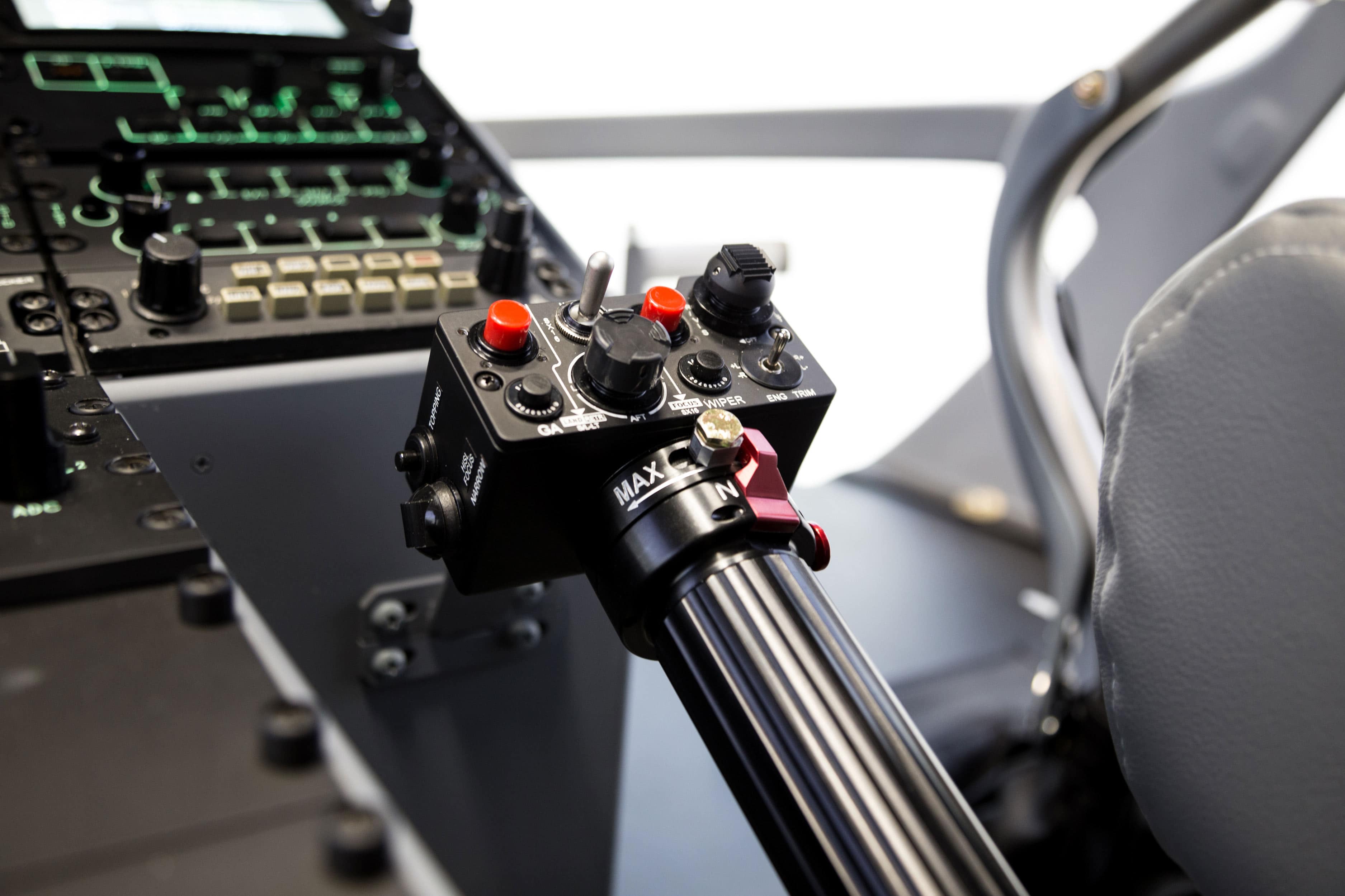

I'm not sure I totally understand what you're saying due to auto-correct, so I'm not arguing for or against you statement, but... If the H135 is picked, there will be a twist grip EP or two. The idea is similar to a fleet aircraft, just the interface is different. I believe the 407 is the same. I'm not sure about the 119, but I'm guessing it's similar to the -60, since it has PCLs.
FERS and TSP contributor!
UH-1Y has twist grips. TH-119 a twist grip for manual reversion from FADEC. The H145/UH-72 has collective mounted rotating twist grips interconnected with FADEC. I would guess H135 would be same! From a few flights in the 407, I remember there is a twist grip as well - but default is FADEC.
UH-72 pilot/copilot collective...
a little google action and here is the H135 collective

Given my post right above yours that states it has one, that's a good guess!
Fair point! My reading comprehension on Sundays seems to be lower :)

Without going too far down the thread jack hole - I'm envious of the H135 collective mounted engine controls. The BK-117 and BO-105 overhead power levers sucked in a single pilot environment. Double sucked on maintenance flights where you had to pull power levers out of FLY for various checks.
