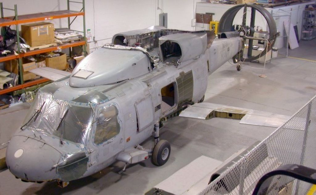

Pusher prop and stubby wings!!!
Somewhere in an abandoned hangar, the X-49 Speedhawk slumbers....waiting
hscs
I didn't know it was a Seahawk derivative. Pitot tubes in the right place. Properly beefy tailwheel (not the baby one in the back). Love it!
Don’t hate on that baby tail wheel- it lets me dump that 13 deg within 15 ft knowledges. But I do really like those side view mirrors. You can actually use them.
That is a Piasecki design. I talked to them at AUSA and they loved how it flies. Of course they are sales guys, and it is to be expected, but they said they were keeping it around for when the Navy or AF needed it!
