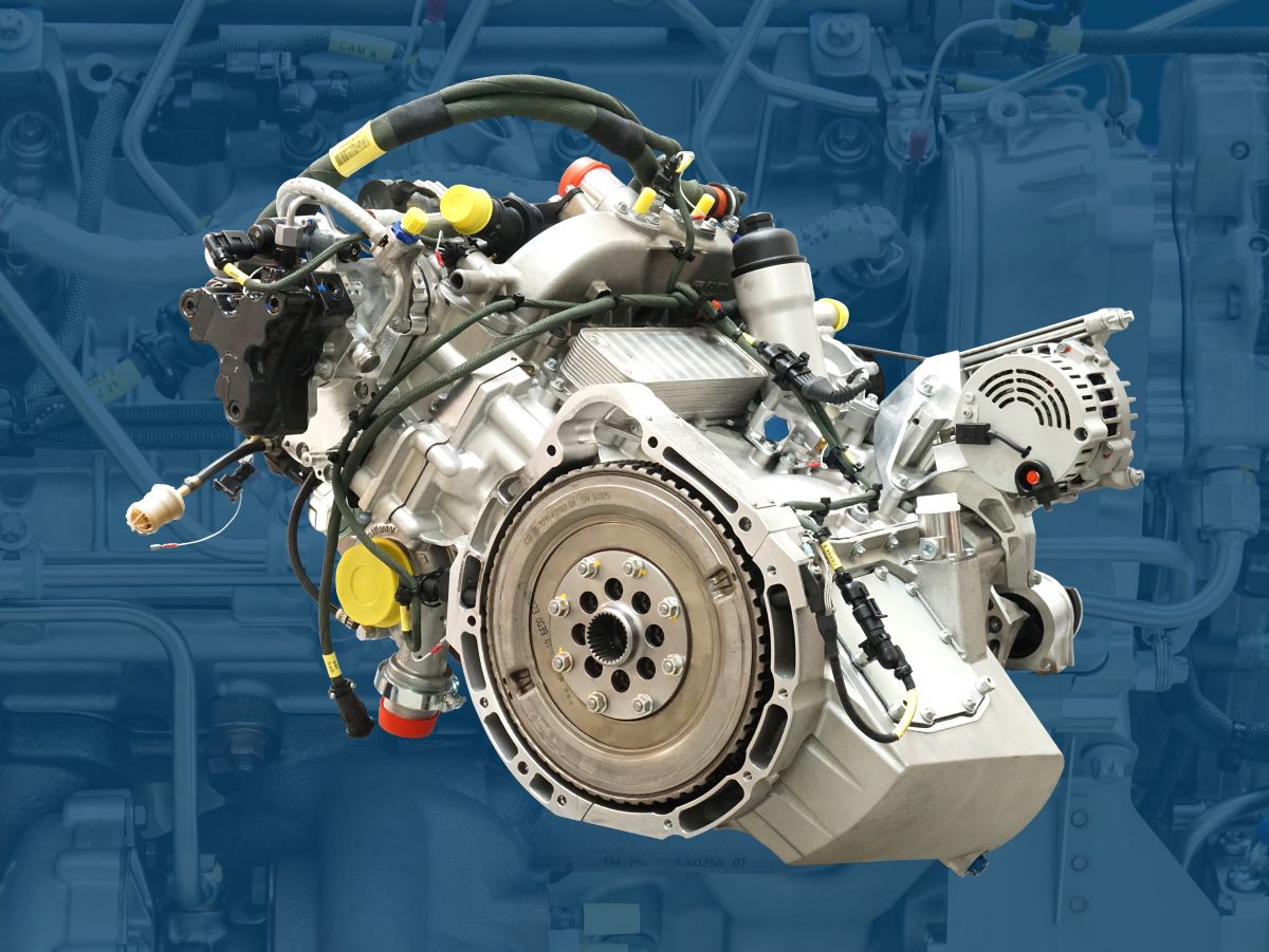

Nice engine, but I’d lose a chunk of horse power at close to the same weight. I do seriously love the idea of a FADEC as I am sick of the 1920’s technology tractor magneto that I have now (made worse in that it is a dual magneto). Even an engine governor would be nice (the Enstrom uses a collective correlator) to save some gas.
The real problem on the US is that once something works…like a 1950’s engine…why bother ever changing it? It is very expensive for companies to meet FAA requirements and most owners don’t care as long as the spinning thingy on the front (or top) keeps spinning. But…100LL is on the way out no matter how much pilots kick and scream. Several states are working on bills that will limit the number of take offs and landings per day at GA airports that utilize 100LL and others are looking at outright bans. In most cases the fox isn’t too hard, but getting past the “but it works” types isn’t easy.
