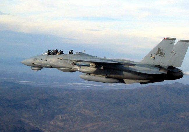

F-14 had a two postion lever marked pilot or MCO (Grumman thought RIO would use term used for NFO in F6D Missileer, which laid path for AWG-9/Phoenix). It was a checklist item for RIO to position lever in MCO for typical fleet hop. If person sitting in rear cockpit was a guest or not really trusted by pilot, the lever was set to pilot like below when guest AEGIS CO went for a ride and grabbed the ejection handle during negative G and inadvertantly ejected himself (he claims he didn't do it...conventional wisdom: V).
