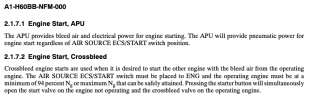

@hscs can correct me if I misunderstood, but I was told by former HS guys in one of my squadrons that the Foxtrot could do a Huffer start.
It was never a thing in the Bravo NATOPs since back then, they usually wouldn't be co-located with a F-14.
I thought the Sikorsky design might carry over, but I guess not.
